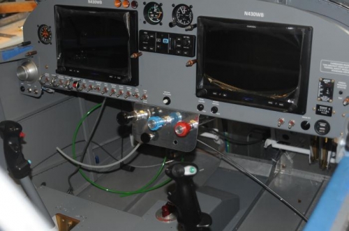

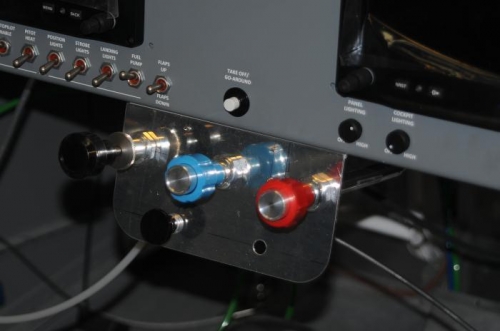

Brief Description:  Prepping throttle bracket
Fabricated and did an inital fitup of the the throtle bracket. I elected to place the cabin heat and alt air knobs below the main engine control knobs -- I want to keep them out of the way. They seem to fit pretty well. Bent from 64 mil 2024-T3; that took some hammering!
Test fit of throttle bracket
Throtle bracket close up
