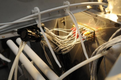

Brief Description:  Terminate grounds to forest of tabs
Cut my "big" forest of tabs down to size, mounted to the firewall, and terminated all the ground returns to this point. This makes for a compact, easy to maintian single point ground for the aircraft. The large bolt goes therough the firewall where it is termianted to a 10 AWG jumper to the battery ground terminal.
Tabs all loaded up
Tabs all loaded up
Top view
Top view
