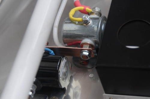

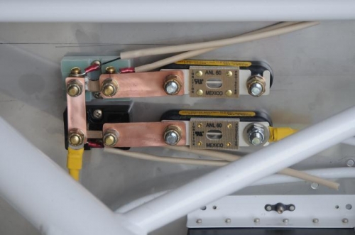

Drill firewalland install current shuts and ANL fuses. One path for from the alternator to the master bus, and one from the master bus to the panel. Added 1 amp fusible links for the EMS current monitoring sensors.
Added copper buss strips to connect the compoents, and the master contactor to the starter contactor.
