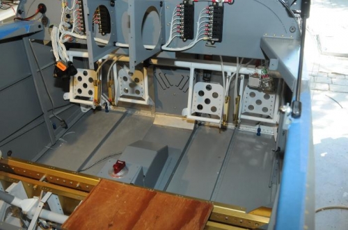

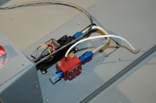

Finished installation of fuel pump and red cube flow sensor. Had to move the pump to the side a bit to make room for the cuge. Everything fits easily under the doghouse cover.

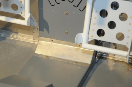

Center photo shows the connection mod for the heater vent cover and the tunnel cover. I needed to "round" the corner for the cable bundle coming forward. Also, this disconnects the heater cover and tunnel cover, making install and removal eaiser.
All covers in place
All covers in place
Detail of the
Detail of the "edge rounder"
Pump and red cube together
