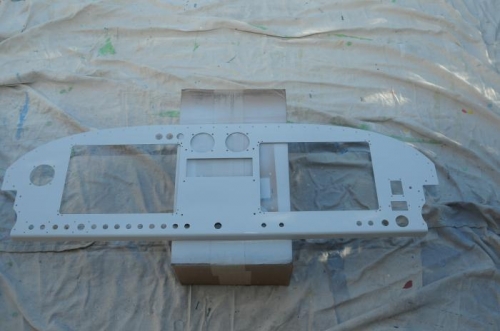

Fabricated a connector bracket that will attach to the lower lip of the panel behind the mag/starter switch area to suppor the panel connector set. This arrangement makes it easy to disconnect the panel from the plane for maintenance, etc. Made from 32mil sheet.
Primed the panel, air duct holders, connector bracket, and misc parts prior to riveting.
The panel will get a super cleaning and fresh primer prior to top coating
Connector bracket
Connector bracket
Primed panel
Primed panel
