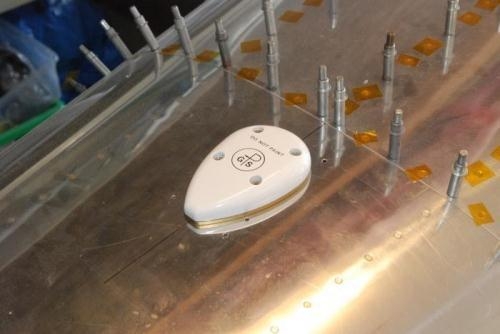

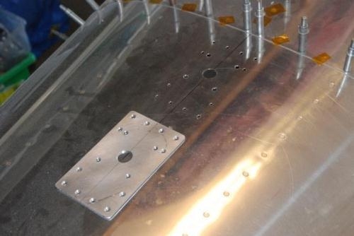

Drill GPS antenna mount
Drilled the GPS antenna mount to the fuse skin behind the bulkhead that also supports the static ports (forward end of the aft top skin). I will have to clean the primer off the inside of the skin and alodine for a good electrical bond.
