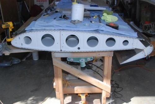

Date:  2-26-2017
Number of Hours:  8.00
Brief Description:  Wingtip fitting 2

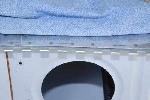

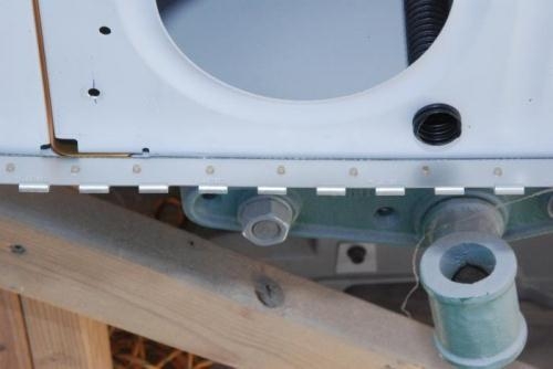

Once the hinge was drilled to the fiberglass tip, I was removed the wing side hinges, trimed the spacer fiberglass at the split-line, countersunk the holes and the skin, and riveted the wing-side hinges in place. Super easy with the squezer. I used a wider hinge on the wing side so that none of the hinge eye cutouts are visible at the split-line.
