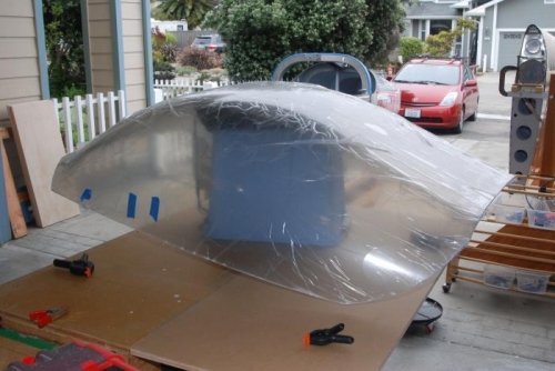

Time to fit the bubble!
Trimmed the obvious flashing and edges from the bubble using a small abrasive circular saw. Put the canopy on the fuse and marked a wide cut and trimmed .. canopy changes shape as stress is relieved! After a number of interations, the canopy profile has been nicely fitted to the forward deck and aft baggage area.
Lightly trimed
Lightly trimed

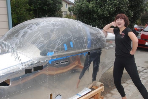

Julianna helping to fit check
Final trim
Final trim
