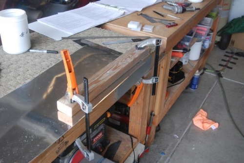

Initial canopy frame fit check. Cleco the glareshield skin to the frame and put it in place for early fit checking. Tuned the skin edge for good fit with the forward skin.
Top skin and frame jigged in place

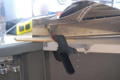

1/8~ gap keeper
1/8~ gap keeper

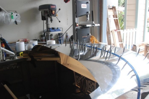

Tuning the gap between the canopy and forward skin
