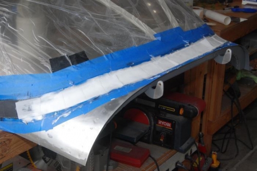

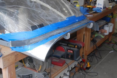

Remove peel ply and lightly sand surface and remove any obvious ledges and crumbles. Trowl on a layer of regular micro to fill in the gaps and voids.
Peel ply off
Fresh surface before filler
Filler in place.
