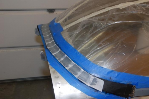

Second run of black pigmented epoxy together with strips of fiberglass to build up the filet region, now extending to the very edges of the masked area. Three strips of fiberglass of diminishing width were appied to build up the fillet. This sets the basic shape/curvature of the fillet. Peel ply surface and allow to cure.
Fillet in place
Fillet in place
w/ peel ply
w/ peel ply
