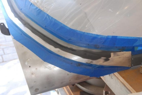

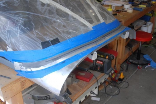

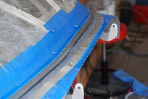

Brief Description:  Canopy fairing 2
Remove the peel ply and begin to sand and shape the fillet after masking off non-sanding parts of the canopy frame and plexi. Mulitple 2" diameter PVC pipes with sandpaper glued to the surface were my friends. Lots of elbow grease and lots of fresh sandpaper required in his business.
Sanded fillet
Sanded fillet
Sanded fillet 2
