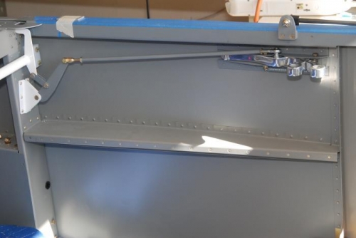

Brief Description:  Canopy fairing 1 / latch
Finished up the connections for the latch pushods and adjusted the latch arms to give just a bit of a pull on the canopy when closed (no rattling)
Removed the canopy and prepared for the first epoxy fillet application. Reset the masking take to define the fillet area, roughened and cleaned the fillet bonding surfaces. Mixed a batch stiff micro with black pigment for the fillet (black so it will look good from the inside of the canopy) Troweled into place, shaped, and covered with peel ply.
Canopy latch complete
