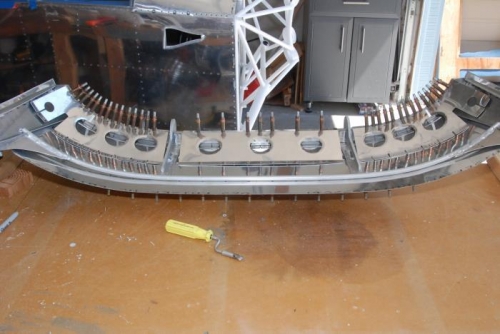

Brief Description:  Fitting canopy frame gussets
Fit the canopy frame stiffeners/gussets. Made the special tool to flare the lightening holes to make them stiffer. Fit in place on the frame and drill final holes. It took a bit of encouragement to form the parts to fit well, but the final product is much stiffer
Fluted lightening holes
Fitting to frame
Fitting to frame
Lots of clecos needed to keep everything tight.
