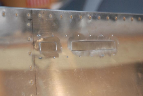

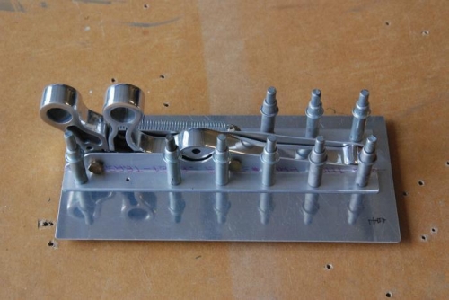

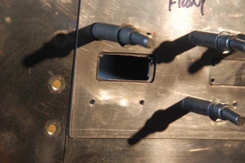

Fabricated a template that I could use to transfer the holes and cutot to the fuselage. Once complete, the template was clecoed in place and the latch holes were cut, and then carefully filed to size. A few on and off cycles were needed to get the cutouts perfect
Latch and template
Latch and template
Cutting the holes
Cutting the holes
Finished install
Finished install
