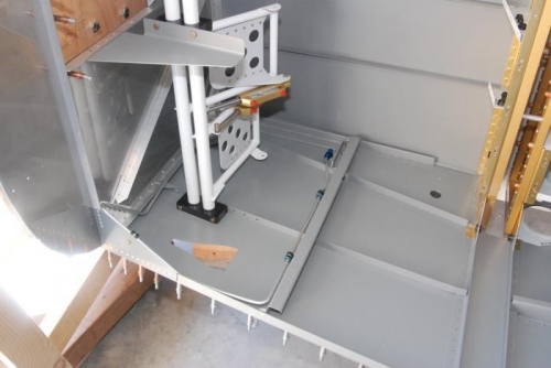

Install tubing for brake lines
Completed left side tank vent.
Installed the nylon brake lines. Definitely needed to boil the ends of the nylon lines to be able install the brass sleeve in the end.
Left fuel vent
Nylon brake tubing; left side
All tubing installed; waiting to tie down.
