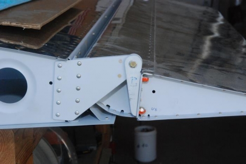

First installation of the control surfaces on the wings. Ailerons went on very easily and used the alignment tool to set the lenght of the fore/aft aileron pushrods.

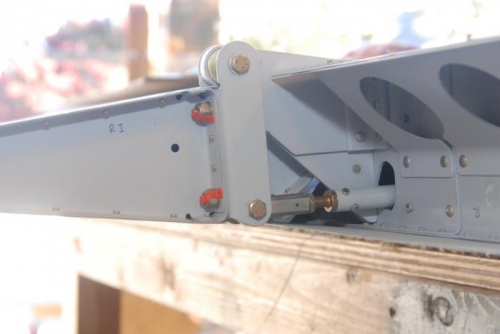

Tried to use the "fat rivet" method to hold the flap brace to the top skin to drill the flap hinges. It took a bit of experimentation to get to hold properly. The bracket kept popping out.
Aileron install
Aileron install
inside bracket/hinge
"fat" rivets mini clecos
