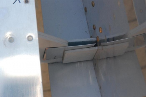

VAF comes through .. aft spar carrythrough is a common non-issue. Use a shim to help get it to pop in ... worked great! Fabricated the tunnel cover between the seats.

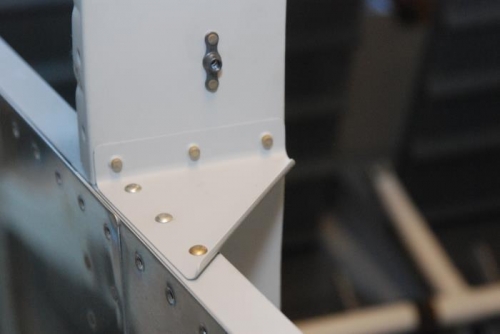

Riveted on the aft bulkhead gussets.
Thanks to Julianna for providing wing wiggling services
Alignment helper
Alignment helper

Bulkhead gusset
Bulkhead gusset
