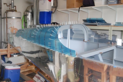

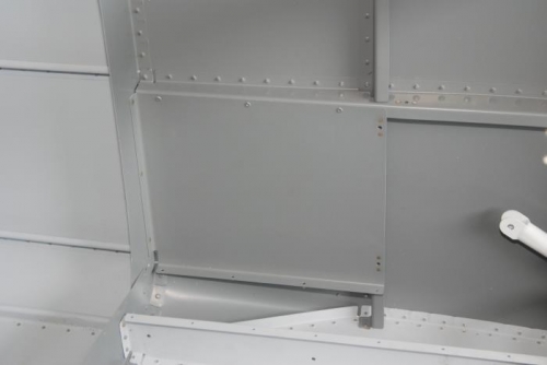

Both top skins are on and gussets are drilled to the bulkheads. Installed aft baggage sidewalls and fitted forward (removable) baggage sidewalls.

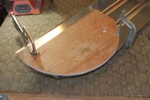

Fore the afte baggage wall, the biggets challenge is cutting the quarter circle into the corregated aft cover. To do this, I took a sheet of plywood, drilled a ceter pivot hole, and gigged up a pivot hole on the bandsaw at the right radius, and the cut semicular arc.
I rough cut arc into the aft wall, clamped on the plywood, and used the disk sander to grind down the edge to wood. Easy, fast, and accurate
Plywood form for the quarter-circle arc.
