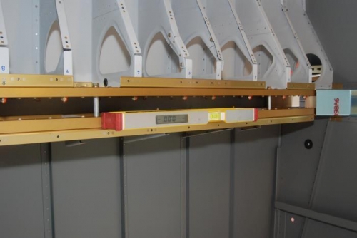

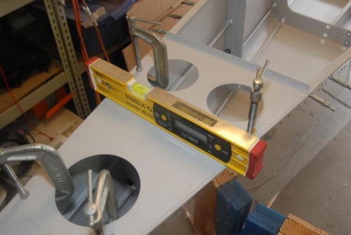

Drilling the aft deck
Jigged up fuse to be level front and back, clamped aft deck and drilled it in. There were no issues getting the spar and aft deck level. Had to introduce a slight reverst twist (< 1 deg) to bring them into alignment.
