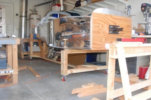

Today was the big milestone day .. time to roll the canoe. I modified the standard Harbor Freight engine stand to bolt to my existing saw horses.
The tail was supported by the tailwheel spring and a 2x3 with a 1" hole to hold the spring.

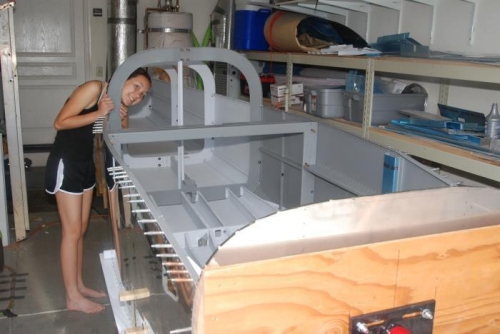

Moved the fuse off the old saw horses and onto the new with the bearings in place.
Rolling wend very well! Super easy to use.
Build a fuselage cart from plans posted on VAF and posititioned the fuse on the cart, ready for the next steps of build out.

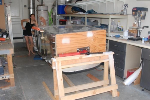

Getting ready to roll
Success; greasy side down.
