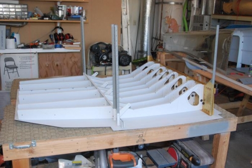

Lots of loose ends to do to prep for reassembly of the forward fuse. Deburred and dimples all the holes in the tailcone and the undimpled holes in the center center bulkhead section.
Cleaned up a few painted pieces from yesterday .. the paint was applied in a booth, but the primer was not and some has significant amounts of crud imbedded in exposed surfaces that were painted. A mild scrubbing with 400 sandpaper and cleaning and it was ready for paint -- and came out perfectly after!
Painted the exposed columns in the center section and aft baggage bulkhead to make things easy later after they were assembled.
Looks like I'm gonna need another quart for the remainder.
Center section with painted verticals
