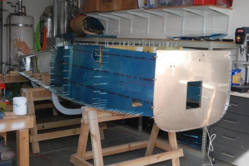

The firewall gets to go on! Hung the firewall on the longerons, clamped it in place and did all the fine measurements to be sure it was in the right place. Had to trim the F718's a bit (1/8") get the fit just right.
Ok, time to drill! Everything went together well and the firewall is clecoed in place.
What a beauty!
What a beauty!

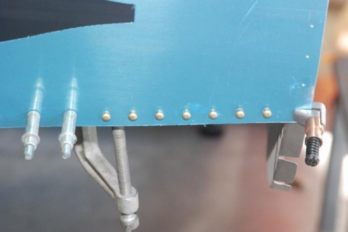

Temporary #4 rivets holding in place

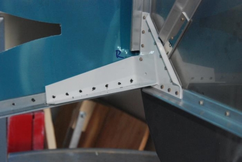

Drilled upper firewall bracket
