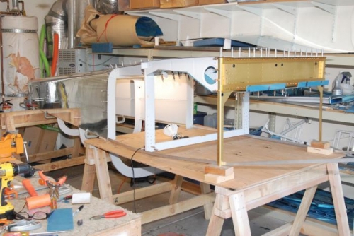

Brief Description:  Initial mating of center section and tail cone
The center section and tail were mated for the first time. I built a plywood table under the center section to allow me to move, joggle, and cajole it into position. It took a bit of wiggling, but it went together fairly smoothly.
The F-770 side skins were them clecoed into place to bring everything into alignment. The longerons needed a touch to tweaking to get them lined up with the 17-degree bend in the skin, bu only about 1/4"
It's good to see the fuse stretched out to full lenght.
We have contact!  Center and tail are joined

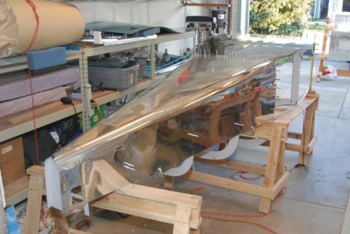

Reverse angle; wing look on in anticipation.
