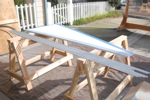

Etch, clean, and prime the inside of the skins and other components.
First time using a DeVilbiss Finnish Line 4 gun, as my HF chepo died. Very nice gun, easy to setup, use, and clean. 20 PSI at the inlet with a 1.5 mm tip for the EcoPrimer worked well

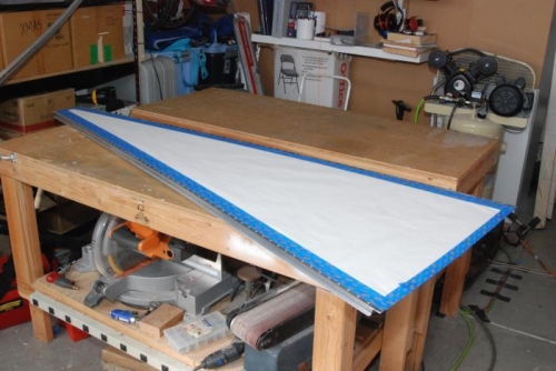

Masking bottom tailcone skin

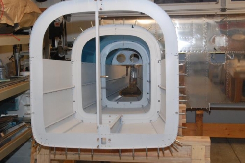

Reasembled
Reasembled
