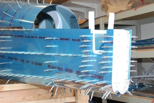

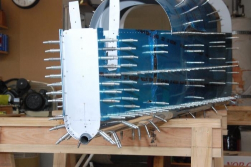

Brief Description:  Cleco and drill tailcone

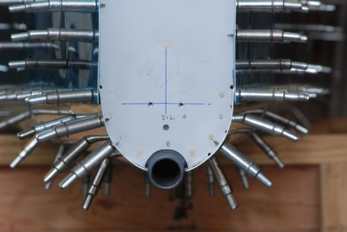

Finished tweaking the tailwheel F-711/F-721/F-779 assembly to get the prepunched holes to line up with the fuse skins. It took some grinding of the F-712 flanges and cutout for the tailwheel weldment so everything would fit snugly. Formed the flanges to match the skin contour.
Clecoed up the skins and, per VAF recommendation, clecoed on the top skins to stiffen up the assy. Great tip!. inserted and drilled the stringers, bulkheads, and skins.
Ready to dissassemble and DDP&R.
