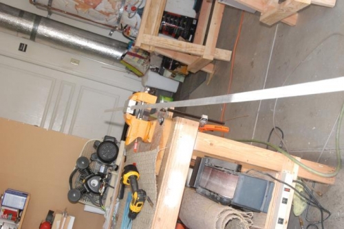

Making the big bend
Using Buller longeron dies, the longerons were carefully measured and marked slowly bent with the dies in the vice. Lots of small bites and checks did it. Slow going but they came out perfectly.
Getting ready to bend
Dies in vice
Bent!
