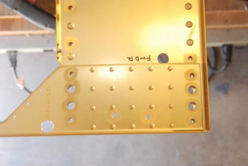

Prep and rivet F704D's to 704B (verticals to horizontals). Drill seat pan ribs to the main spar passthrough.

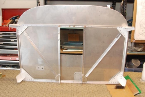

Prep and rivet stiffeners to the firewall. No primer or paint on firewall!
Match drill
Riveted in place
FW stiffeners in place
