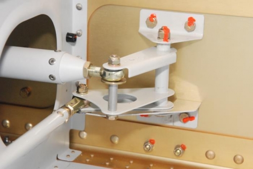

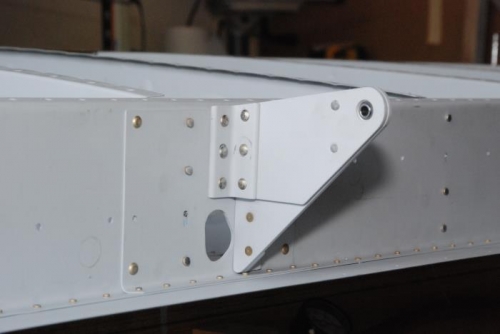

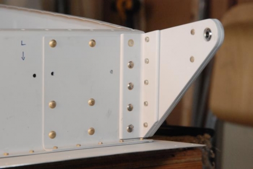

Installed the aileron brackets on the left trailing edge,
Installed the left bellcrank and torqued all the bolts. It took 4 off/on cycles to get the brass bushing burnished properly and everything lined up to make the pivot frictionless once eveything was torqued down.
