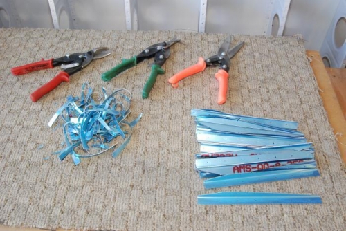

Started on the ailerons; trimmed and deburred the 32 stifeners.

Cutting the aileron stiffeners
