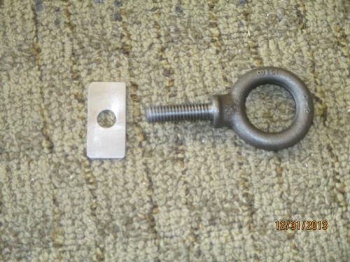

Spacer for tiedown to skin gap

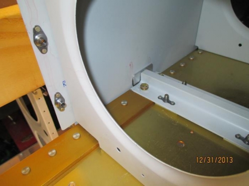

Spacer prosealed in place
