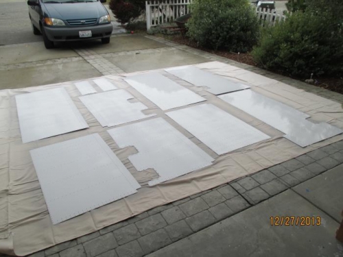

Cleaned and etched inside of wing skins using Stewart Systems EcoEtch and a spray bottle for applicaiton. Scrubbed them down with a scotchbrite pad, rinsed, scrubbed with water, and rinsed again.
Primed with EcoPrime. This is the easiest thing yet to prime ... all perfectly flat!
Etching inside of skins
Primed ... pretty
Primed ... pretty
