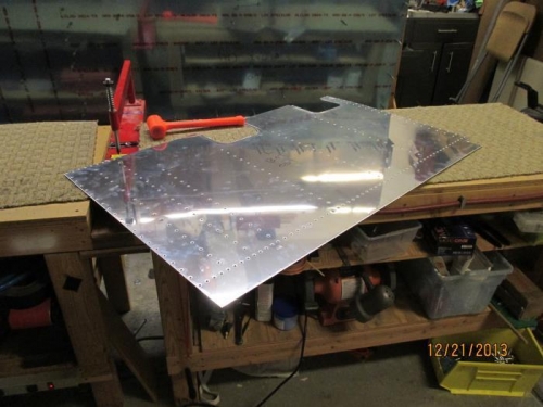

Brief Description:  Main wing skin prep .. part 1
Starting to prep the main wing skins, starting with the bottom skins.
The process:
1) Hand file edges to take out major burrs.
2) Use die grinder with a blue roloc disk to deburr the edge
3) Flip and deburr the other side
4) Deburr the rivet holes.
5) Dimple on the C-frame
Threre are alot of rivet holes on these things...
Finished two inboard bottom skins
