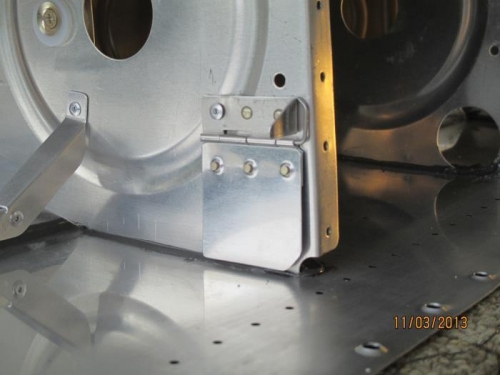

Replaced the folded rivetes on the right outer tank flange .. keeping most of the proseal off the rivets and using the hand squeezer is the best method I've found

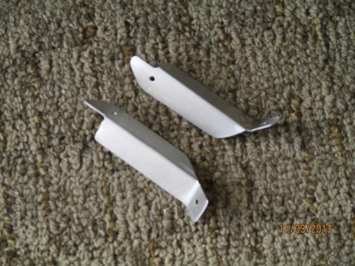

Added the anti-hangup fittings to the L and R tanks. These were fun to build and install.
Fabricated the L and R trap-doors for the L and R tanks; riveteed in place and safety wired he L and R hinge pins. Had to use some pop rivets for the formed part ofthe rib.
