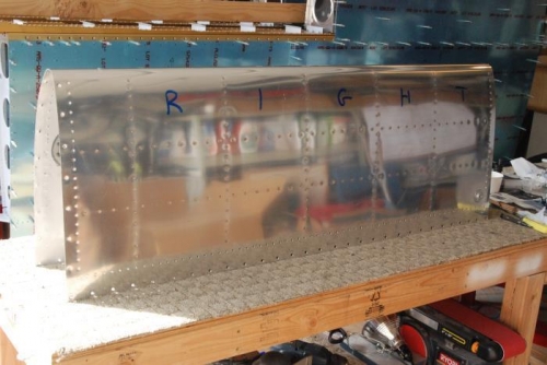

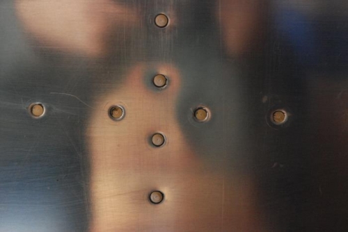

Wet riveted the left tank .. found quite a few folded rivets (10 ish) that needed to be drilled out and replaced. The slippery proseal requires that the alignment of the gun and bucking bar is near perfect.
Right tank with main ribs in
Rivet view 1
Rivet view 2
