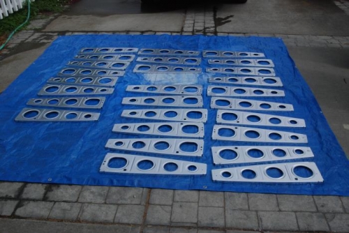

Date:  8-18-2013
Number of Hours:  6.00
Brief Description:  Wing rib prep and priming
All the ribs for the wing are pre-drilled and ready. Finished deburring of all ribs, wiped them down with acetone, ran them thru AlumniPrep for pre-prime, and then priming with my favorite Stewart Systems EcoPrime. 28 ribs, with 5-6 operatons each sure takes a long time to get them done. Though, there is a big Zen factor and things proceeded quickly.
One fail was that a cleco didn't engage a hole but pushed the rib sideways at the rear spar, making one of the drillings quite ugly. This is a do-over; I don't wanna event to try to salvage.
"Fail on a stick" This is what happens when a cleco goes wrong.. (O,h, vans, send me another W711R)
Hon, what are we having for dinner tonght?  Ribs!
Oh, so pretty!
Oh, so pretty!
