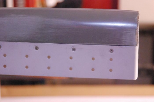

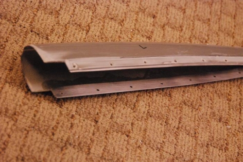

The elevator tips were pop riveted on to the elevator ends. I elected to bond on a strip of 25mil alumnium inside the tip as a reinforcement strip ... it seems that the fiberglass alone doesn't have enought strenght to really hold.
Applied a generous bit of epoxy to the lead counterweights, slid on the tips and popped away..
Ready for install ... with Al reinforcing strips

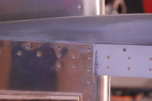

Attached!
Attached!
A bit of a gap bet skin and tip ... a bit of filler will fix
