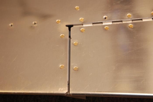

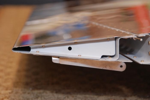

OK ... putting together the full trim tab. Riveted up the basic trim tab. Adjusted the positon of the hinge on the elevator, clecoed, and match drilled.
Carefully aligned the trailing edges using an aluminum L-extrusion, and match drilled the elevator side. Set as many rivets as I could with the squeezer (sometimes, the hinge loops get in the way)
Overall, the final alignment looks great ... and the trailing eges line up well. Woo Hoo!
Riblet du jour!
Riblet du jour!
Nice gap
Nice gap
