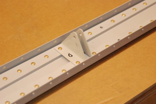

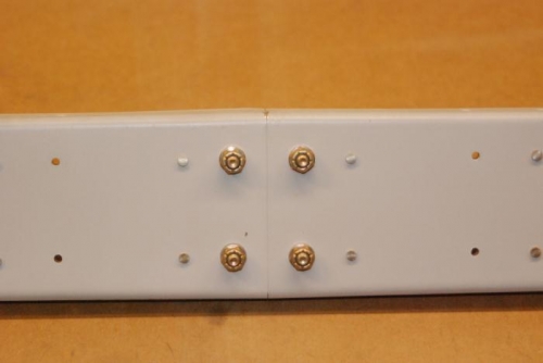

Brief Description:  HS spar assembly
Assembled and riveted the aft HS spar and attached elevator brackets. The rivet squeezer sure make it easy! The outisde bracket rivets were a bit long; folded one over and drilled it out. Should trim down rivets a bit if a bit oversized. Need a torque wrench to torque bolts!
The big boy!
The big boy!
Mid bracket and stiffeners
Center bracket attach
