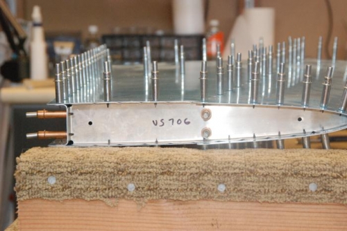

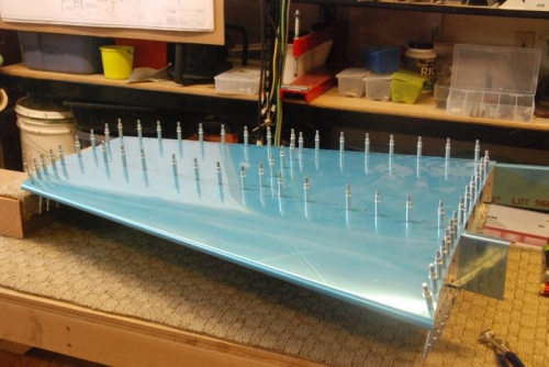

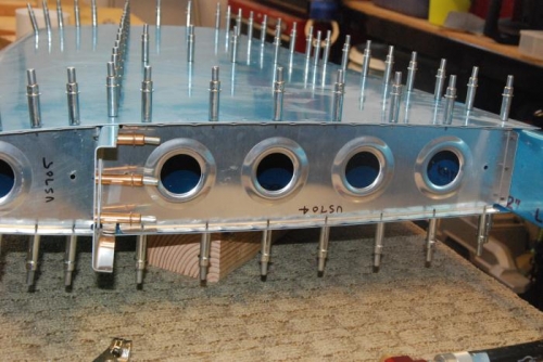

Started VS. Deburred and fluted (flattened) the ribs. Clecoed the frame and skin and match drilled per the instructions. Disasembled, deburred, dimpled. Found that the C-frame did a better job on the skins than the squeezers, so all skin dimples were done with the C-frame. VS reinforcing bar was machine countersunk. Ready for cleaning and priming
Root end clecoed

Skin drilled
Skin drilled
Tip end
Tip end
