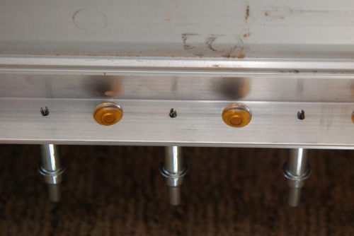

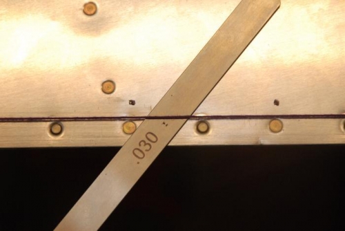

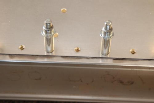

Riveted the rudder trailing edge and formed the leading edge. Using a technique from RVPlane.com, I drilled out every other hole in the stiffening angle to 1/2 inch, re-clecoed and squeezed the rivets with first the alligator squeezer and then the hand squeezer. I slowly set the rivets, adding 1/32 think washers to progressively set the rivets. In the end, the shop head was almost perfectly flush. This handled half of them; for the other half, I flipped the rudder, loaded the other half of the rivets. Here, I can't cleco the angle on using through-hole clecos, so I used the edge grippers and worked on one section at a time, and them moving the grippers. This did not work quite as well, since the angle could slide a bit , but still did a good job. The edge sure stayed straight, though. After stretching a string on the concave side, a feeler gauge of 0.030"" would fit under without contact (0.032 wouldn't). To the eye, it's perfetly straight!

Alternate rivets ready for setting
View of drilled stiffener angle
The final edge! 30 mils max!
