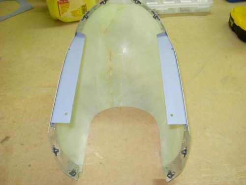

The wheel faring brackets, splice strips and nut plates were riveted to nose fairing front.

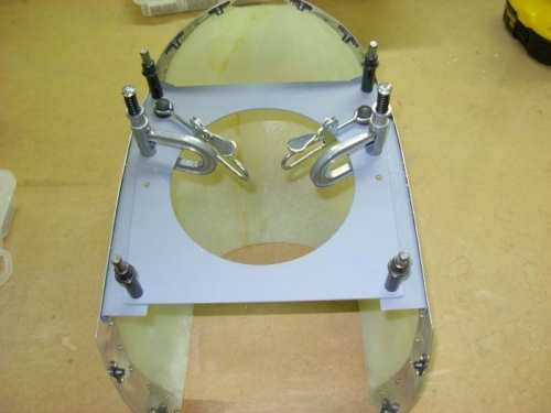

Attached drill template to wheel fairing brackets and match drilled holes for nose fork screws.
Front nose fairing
Drill template
Match drilled holes for nose fork screws
