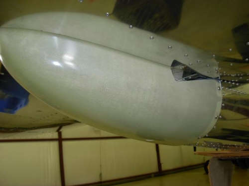

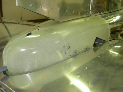

Riveted nut plate to tail cone.
Installed the upper and lower tail cone fairing.

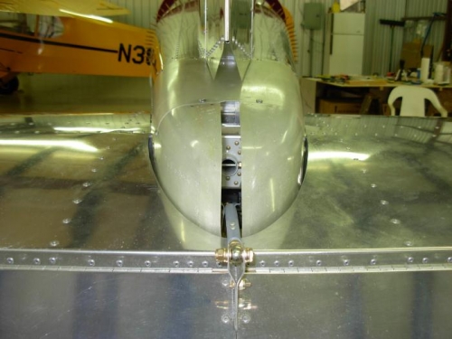

Check for clearance, removed fairings and trimmed for at least 1/8 inch clearance on all sides through full travel of stabalator.
