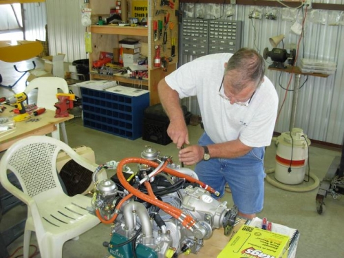

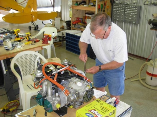

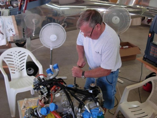

Engine Installation
Repositioned water inlet elbow.
Marked electrical connectors and removed.
Removed and replaced the bolts in the water pump.
Checked trigger coil clearance.
Removed ignition module.
Removed intake manifolds.
Removed hose/expansion tank assembly.
Marked and removed one starter lug.
Marked and fitted cooling shroud.
Removed lower coolant hoses.
Installed engine mount.
Applied RTV and attached cooling shroud.
