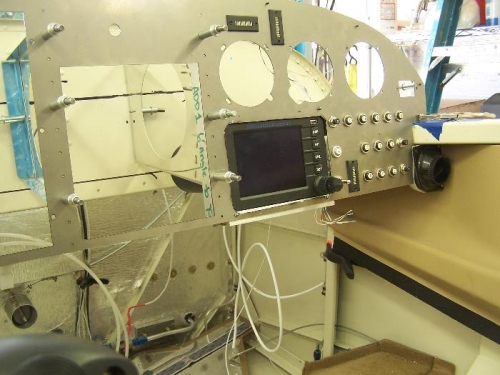

Well, I dreamed about this last night. I'm going to trial fit the Lite recessed in the panel and see if it will work for both the control stick and the rear wiring.
Yeah, looks like I can get .5" lip on the EFIS mounting bracket so that I can use 4 screws and platenuts for front panel mounting. The EFIS will snug up from the rear of the panel.
EFIS recessed
EFIS recessed
Lost some rear space
