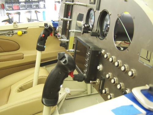

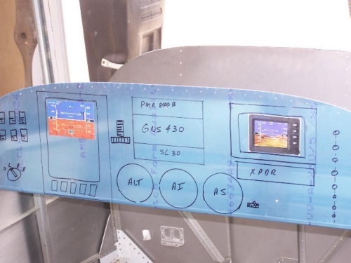

I picked up prototype panel number 2 yesterday afternoon. Looks good but the laser wasn't at it's best so I'm filing rough edges. I mount all the instruments that I have, I'm still missing the altimeter and radio stack.
I mount all the switches and circuit breakers as well as indicators. Now comes the moment of truth as I put it in the airplane. Oh yeah, just to make sure I put in the interior and copilot stick.
Houston, we have a problem! The copilot's stick hits the EFIS Lite Plus selector switch when in the full forward positon. I don't like BMA's mounting face plate on the lite. It causes the Lite to really stick out from the panel. I can't move the Lite so my only choice is to recess it.
Proto # 2 showing conflict:(

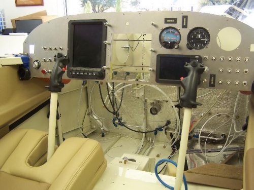

EFIS and switch location good
