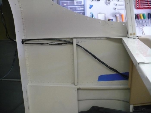

Brief Description:  Wiring
I am still running point to point wiring. I decided to clean up the interior and label the terminal strips to ease identifying what goes where. I'm running all the nav and GPS coax down the left side of the plane all by themselves in order to eliminate any noise caused by transmitters and strobes.
All nav wiring down left side
