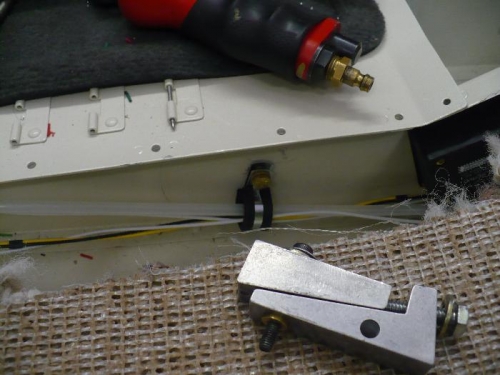

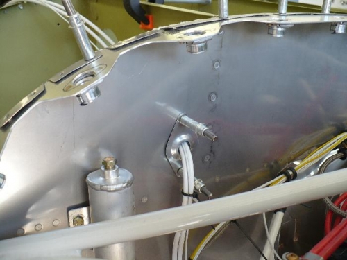

I installed the firewall pass throughs and ran the wiring through them. I extended the wires for the OAT and mounted it. I extended the wires for the fuel flow sender and wired it. I installed pem nuts in the center well of the fuselage for adel clamps to secure the wiring going through the well so it does not interfer with the control tube.
Firewall passthrough
The other passthrough
Pem nut tool and one of clamps
