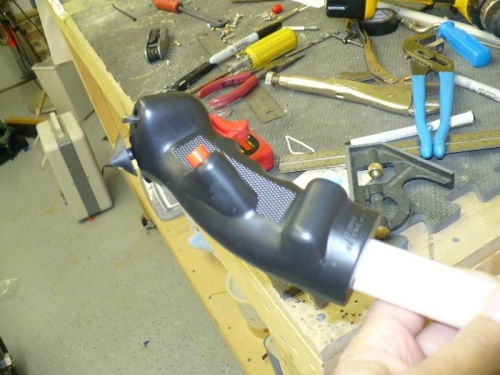

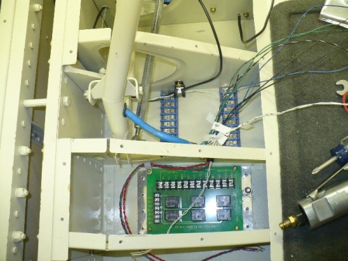

Continued wiring. I took the pilot control stick apart and drilled an exit hole for the stick wiring near the pivot point of the stick. I then fastened the wire to a floor rib with an adel clamp. Mounted the servo relays and started wiring sticks.
Removed handle to drill stick
Wiring exits near pivot point
