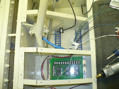

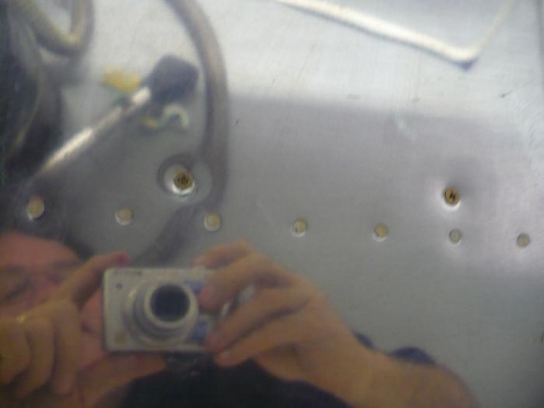

We're back from Denver and I layed out wiring runs while there. I'm installing 4 terminal strips to handle the control sticks and trim servos. I'm trying to make most service a one person operation so I made nutplates for terminal strips. The screws come up from under the fuselage and the nutplates hold the terminals in place. I also made a standoff bracket for servo relays.
Terminal strip screws
Terminal strips and servo relays
